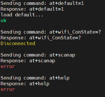

别的指令都正常,就个at+scanap返回error。芯片上的丝印就是HLK-B35-V1.0
wifi_init
Sending command: at+default=1
Response: at+default=1
load default...
ok
Sending command: at+wifi_ConState=?
Response: at+wifi_ConState=?
Disconnected
Sending command: at+scanap
Response: at+scanap
error
Sending command: at+help
Response: at+help
error
Sending command: at
Response: at
wifi_init ReaderConfig.ser_cli_config.ser_cli = 0
Sending command: at+uart=115200,8,n,1
Response: at+uart=115200,8,n,1
ok

模块的丝印是硬件版本,你可以用at+ver=?指令查询一下模块的固件版本,然后找我们的客服拉技术群来进行具体沟通

正确的指令应该是 at+scanap=1
